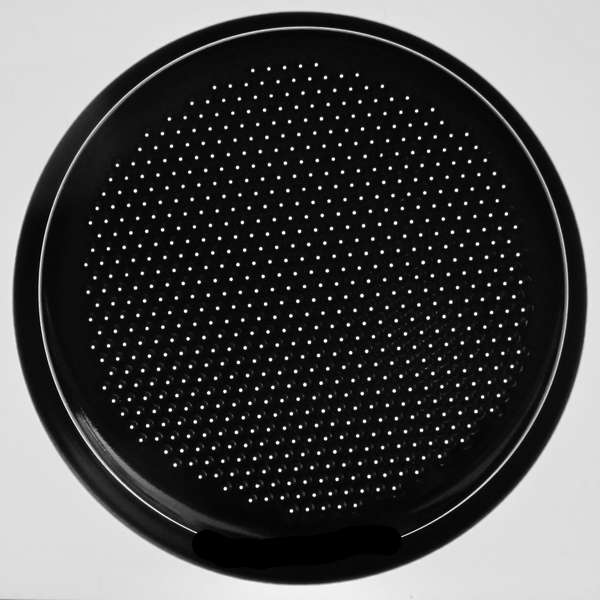

Steps to Make Scott Rao's Filter 3 Coffee
Preparation
  • Pour 22g of very coarsely ground coffee into the basket.
  • Give it a gentle shake to level the grounds.
  • Flush the group head (using the Decent “Dimples” shower screen, which has 50 small protrusions to ensure even water distribution).
Brewing Process
  1. Latch the basket onto the machine.
  2. Press the buttonto start the brew—everything else is fully automated.
    • The entire process takes ~4 minutes.
Optional Manual Check (At ~100 Seconds)
  • Remove the basket to check the slurry level:
    • Optimal grind: Slurry is ~50% up the basket.
    • Too coarse? Slurry is 60% or higher → use a slightly coarser grind next time.
    • Too fine? Slurry is below 40% → use a finer grind next time.
Filter 3 Profile Details
  • Pre-wet phase: 3:1 ratio (~66g water for 22g coffee).
  • 30-second bloom follows pre-wet.
  • Slow-flow stages with gradually declining water temperature (to avoid over-extraction).
Expected Results
  • Extraction yield: ~22-23%.
  • TDS (Total Dissolved Solids): 1.4-1.5%.
    • If too strong, dilute with 30-40g water after brewing.
Why Filter 3 is Great
  • Simple & consistent – just press a button.
  • Time-saving – ideal for events or roastery use.
  • Reliable – produces perfect filter coffee every time.
Filter3 baskets are available at Scott Rao's web store and at Decent Espresso's website.
