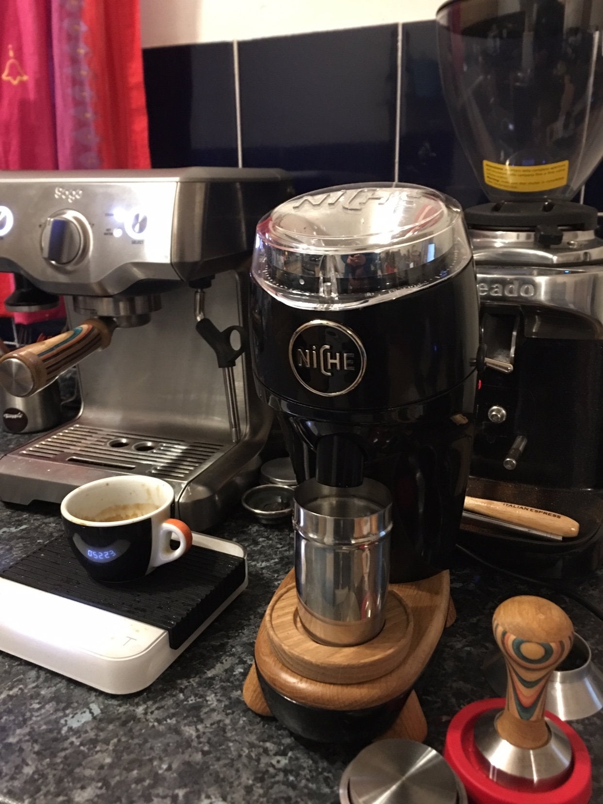

Finally got home to mine. Only pulled one shot so far on a guess following 18g through it and thrown away and already that was a tasty one, despite a bit of inconsistency showing under the naked pf and a bit of a slow pour. I just tipped into the pf with a jiggle, levelled and tramped. No doubt there's work to be done there but the work flow is so clean and easy.
"Finger tight" it seems to me could give a range of at least 5 units depending on one's interpretation of it. Looks like my interpretation will take me to low teens for an espresso grind on these beans (Foundry Rio Magdalena Columbian). I could've tightened it less on calibrating and still called it finger tight.
Glad to hear that the retaining nut bears no relation to alignment but it'll drive me mad so I'll have to try & centre it.
First grind I got 1g retention. If, over a few test grinds the total in doesn't equal the total out I'll open it up and look for the retained grinds.
Next I'll make some coffee!

Ok so I've found the missing grinds by giving the chute a tap.
I've gone from the delivered setting of 20 down to 15 to get back to my usual 45sec shot (8sec 2bar then up to 9 and a slow descent).
Still getting sour shots but I'm wired now so am stopping for now. FWIW I prefer sour to bitter but it's going to take me a bit longer to dial in.

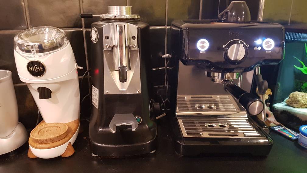

Loving my Black coffee corner but now I need more cupboard space to store all the gubbins previously left on the Mazzer's big tray!
