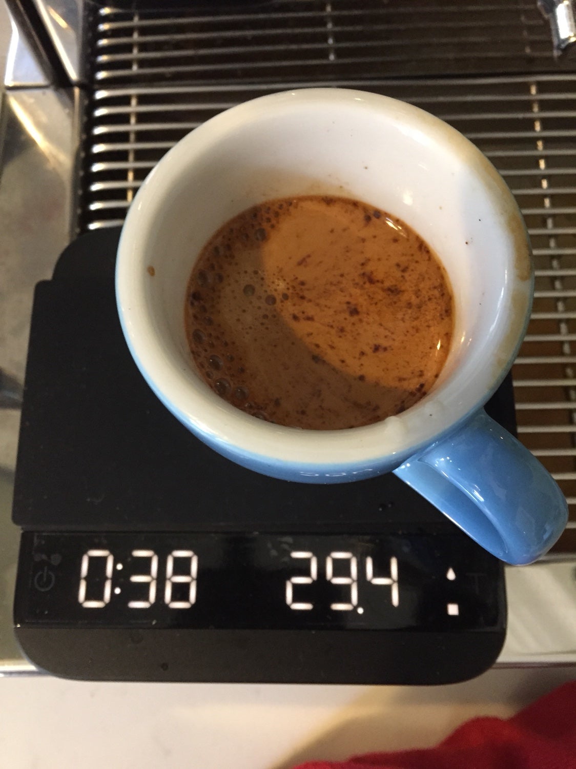

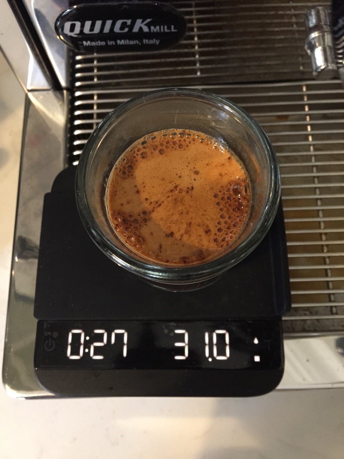

So, an interesting idea experiment today.
Two shots. Back to back, no change in grinder setting.
Shot 1 - I got distracted by my 3-year old, so a 10-15s PI, then retarding the lever for about 5s then full spring power:
Shot 2 - as a comparison I went for a 1s PI, then no retarding of lever - gentle release straight to full power.
So, what are we learning from this?? Medium to light roast fresh beans - Django Los Pirineos - vac sealed and frozen at 7 days, now frozen for 3 weeks.
- A longer wetting of the puck definitely increases flow speed.
- visibly, the crema on shot 2 looks better extracted - more coffee oil spots maybe?
- difficult to be certain that Shot 2 tasted better, but it did have a deeper finishing flavour and possibly a nicer mouth feel
So I am not necessarily improving things by faffing and excessively wetting the puck.
