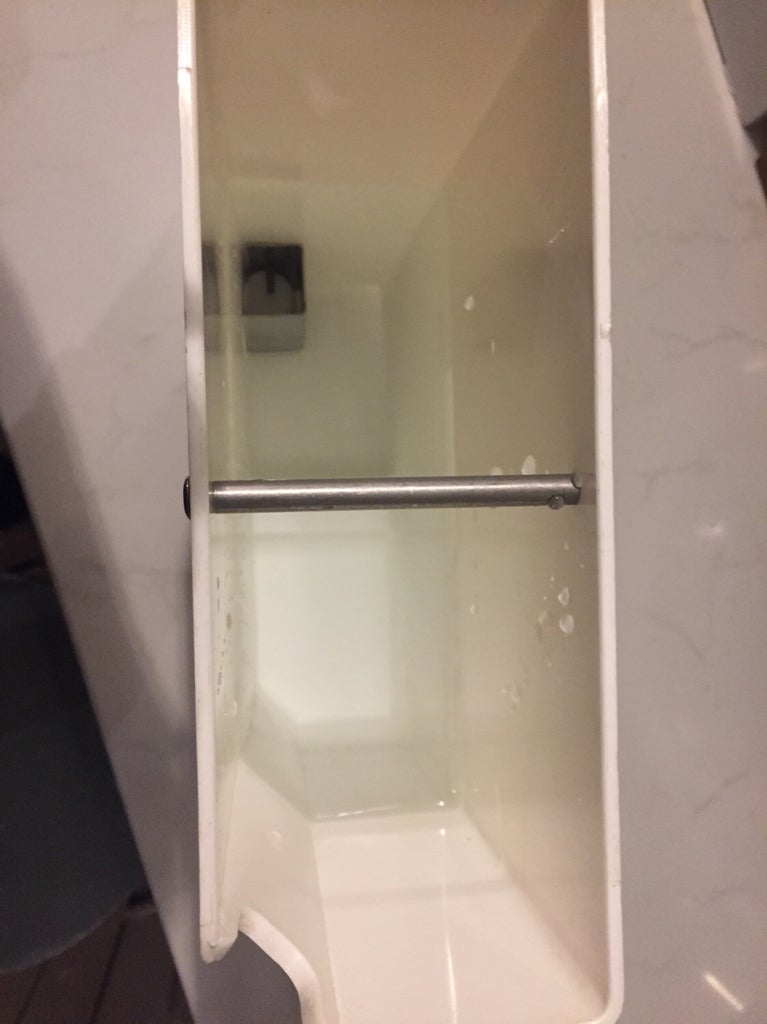

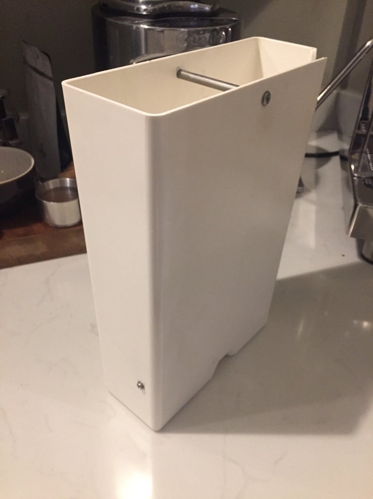

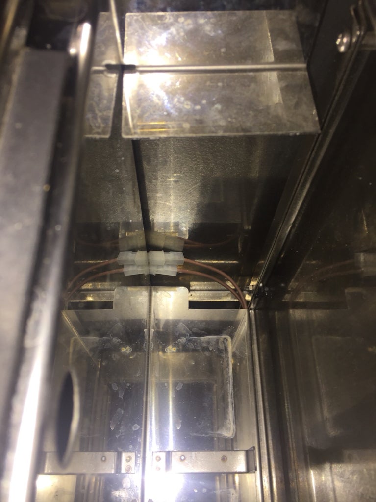

So I'm not sure this is equipped with a low water warning system - nothing obvious in and around the tank.
Here is the reservoir:
The external screw relates to this weird structure on the bottom corner inside of the tank? Do we know what that might be?
Can't see any cables or sensors in the reservoir "bay":
Focussing on the area next the screw and weird internal structure:
I do think this needs something to warn that you are about to run out of reservoir water as the tank is so far away from the user it is hard to regularly check. Is it common for such a machine not to have an alarm?
looks like a magnetic float albeit without sensor
That's what I thought - it rattles when empty so seems to have some movement - sure it must be supposed to be a sensor.
grumpydaddy said:
That "bolt" in the side of the reservoir, does it line up with a contact of any kind on the housing?
I will look again tomorrow but don't think the bolt does line up - certainly can't see anything on the photos. The area around the tank was surprisingly free of any sensors or wires.
Wires may be under that base plate. Might be spring loaded like on my Izzo which detects the weight of the tank. If that base plate moves when pressed that's probably where your sensor will be, if there is one there.
