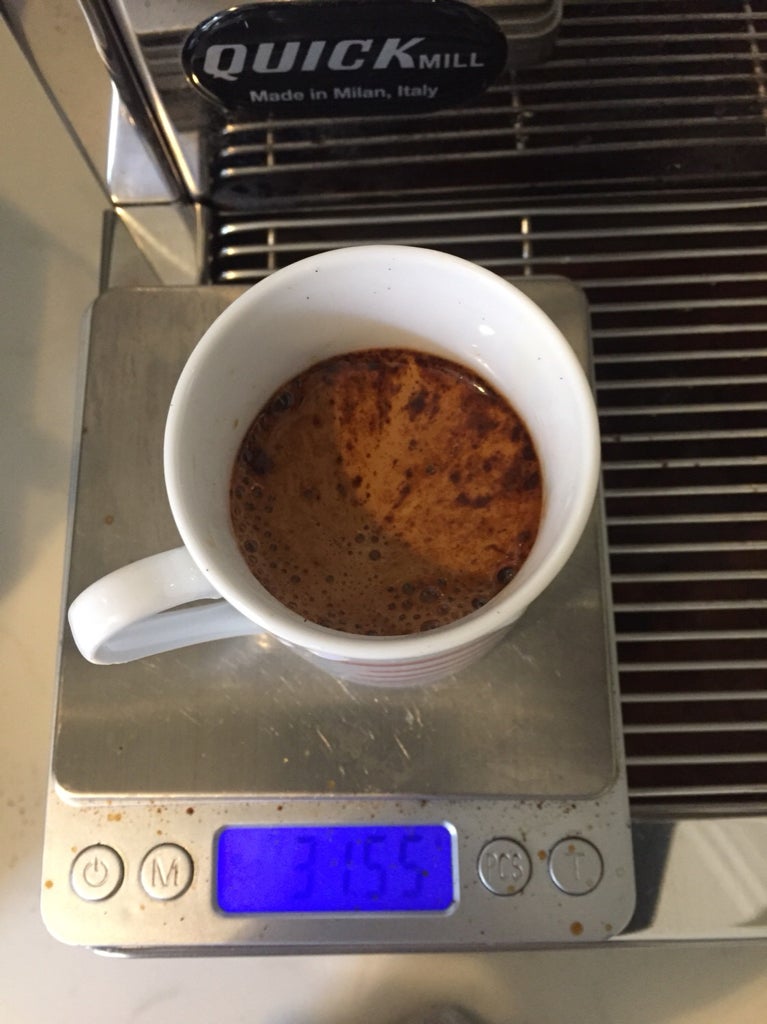

I am loving the silent pours (once the vibe pump has done its thing!). Below a photo of a very tasty shot - 16g in, 32g out, poured into 10g of hot water in the cup.
Congratulations.....the lever down is the equivalent to pre infusion. I used to do this for a minimum of 6 seconds and a maximum of 10. The determining factor for me, was after raising the lever how long took for the first drops to appear. Do not start your count until the stream has started and then, and it is only a guideline, I used to time the shot from 20 to 30 seconds. Taste will keep you right.

Great! As for PI, a bottomless portafilter and a shot mirror are of great help. What I do is wait until the bottom of the basket gets covered with coffee, then increase the pressure (release the lever in your case). The shot in your video looks great!
