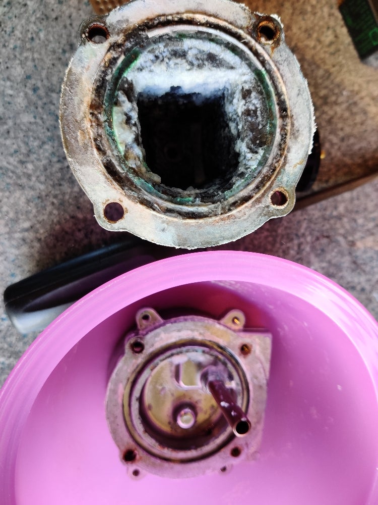

Whoa! Okay, I got it disassembled and I think it is all original from 2006. The shower block has 3/4 water channels blocked and a lot of corrosion. The gasket (I think) is original and was so brittle that it came out in pieces. Here are some of the pictures of what I found and why regular descaling (and deep cleaning) is important.
Drain Font Circle Button Metal
Cuisine Dish Circle Automotive wheel system Metal
Tire Wheel Automotive tire Tread Motor vehicle

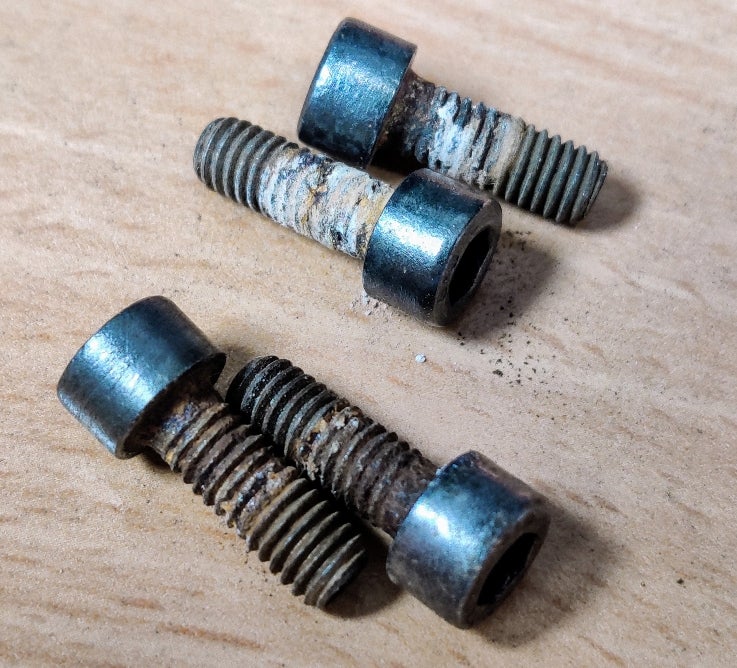

This is why you order replacement bolts before you tear down your machine for cleaning! These boiler bolts took a LOT more force to remove than I was comfortable with, but they did come out eventually.

That machine has had a hard life!
Yuck.
Yeah, you could say that. :(
