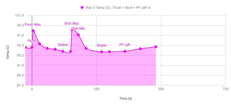

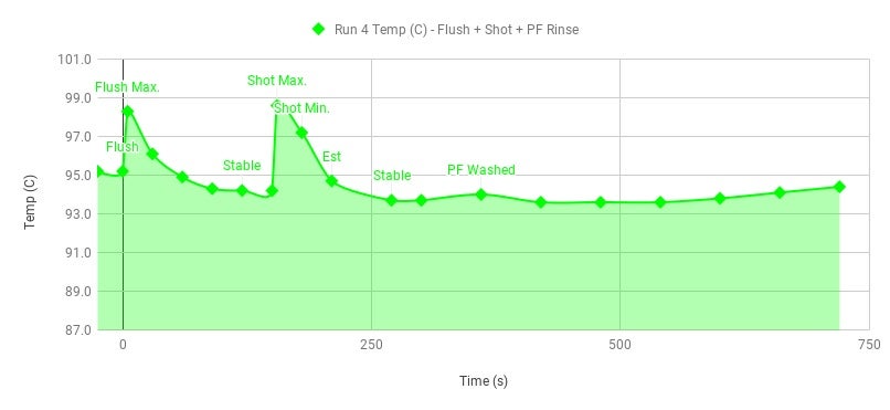

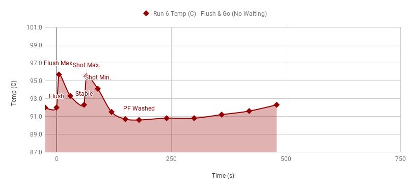

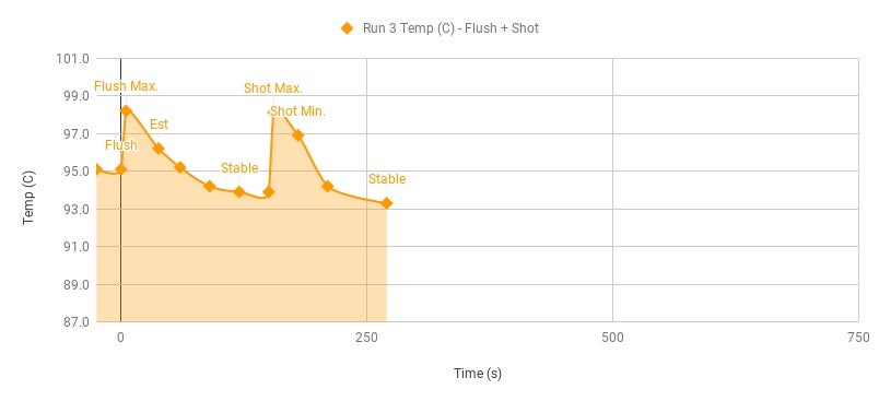

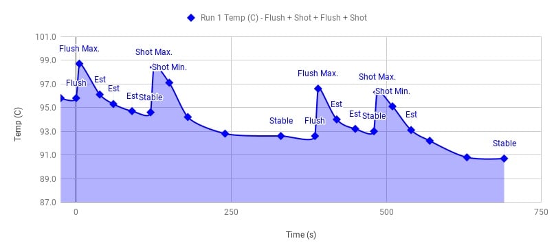

I've copied the graphs from the other thread here in case it's useful.

I had a couple of questions about the charts above.
1)
If the flush max and shot max are around the same (or within 1 deg C) then the flush appears to make little difference. why would you bother ?
I suppose i would've expected the flush part to run 100+ and the the subsequent shot to run cooler.
2)
How important is the Shot max/min vs the average temp over the extraction? Does a high temp for the first few seconds matter if the temperature drops off for the rest of the shot.
Thank you!

In partial answer to
1)
2)
1. The thing to remember is that when sitting idle, the thermometer is measuring the group head temp, but after water has been flowing for a few seconds, it is measuring water temp.
The flush and pulling the shot use different water volumes and so the temp change is very different... therefore will produce very different curves. A 30-second flush will drop temps significantly, whereas a 30-second shot will not. Without the flush, the water temps would stay much higher in pulling the shot, because back pressure restricts water flow. The flush has also drawn cooler water into the HX. The 4+Kgs of brass in the group head also flattens things out.
2. This is where there is debate as outlined above. The water initially hitting the puck will be instantly cooled, because the puck will be at a much lower temp. After 15 seconds my temp stabilises and it makes sense to me that the puck has come up to temp and the group head has stabilised the water temp.... hence I suspect the temp of the water hitting the puck has converged with the group head measurement.
