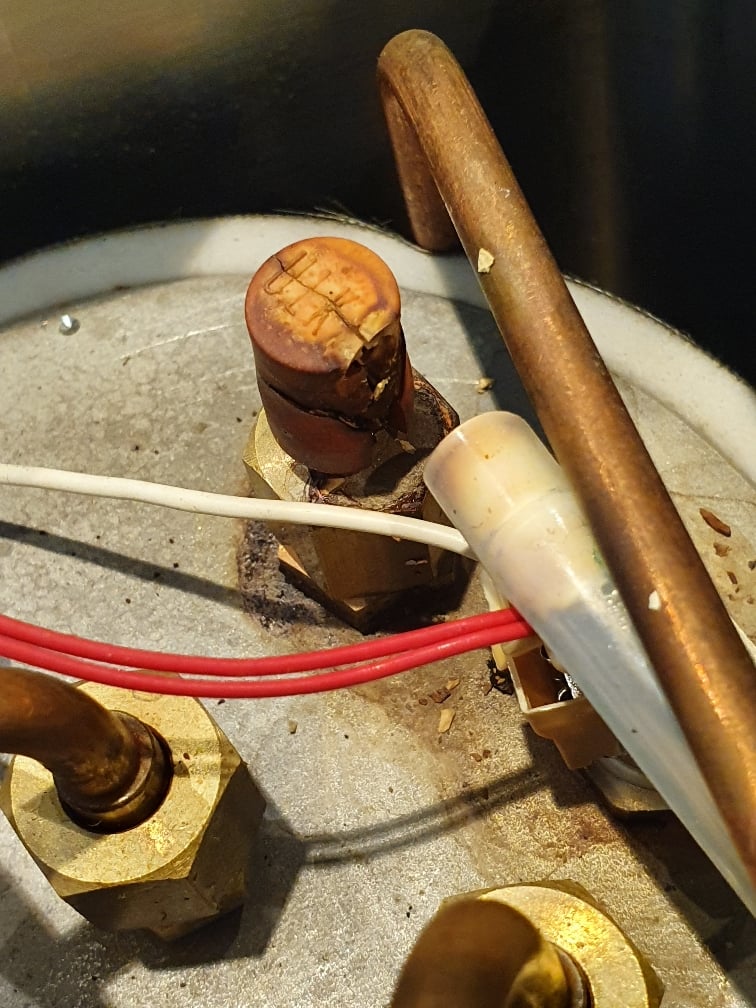

Just giving the bianca its first annual check this morning and found the connector between the silicon pipe and the service boiler anti vac valve had failed, see first pic below. The connector was an ulka part identical to that on the expansion valve. on removing the connector it simply crumbled into pieces, most likely due to heat cycles. So as a quick fix I cleaned up and connected the silicon hose directly onto the anti vac valve with the intent of replacing the connector later.
On looking at the images of your machine it looks like the pipes connect directly anyway. So my temporary fix will now be more permanent.
This does show the slight variations in the build of machines. I suspect others may have the same problem as me.
